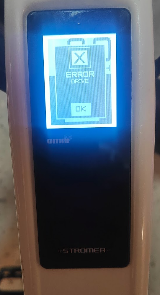

Drive Error message on OMNI at ST2 - bronis14 - 23.03.2025 Hello everyone, Apologies to type in English ... I have ST2 (manufactured in 2015) The bike hasn’t been used for more than a year. - I have recharging a battery via connecting directly a charger to a battery - I have put a charged battery in a bike, locked the battery door and turn on OMNI. the bike on I get an error: - The "Error/Drive/OK" message has appeared on a screen. I click OK and get a new error: - "Battery/Error/Help" on a screen. I click on "help" and get instructions how to fix an error on a screen. - I follow instructions, but it brings me back to "Battery/Error/Help" screen. My guess is it is not an issue with a battery. I have 2 batteries and both of them produce identical issues when they are installed on a bike. When battery is connected to a charger directly (not through a socket on a bike) I get green light. It is also unlikely that both batteries are malfunctioning. I am trying to figure out how to troubleshoot and maybe fix this problem. Stromer has left USA and Canada markets in 2024. Repairs become a challenging task. Many thanks for your suggestions. All the best. RE: Drive Error message on OMNI at ST2 - MarkusSi - 23.03.2025 The Errors should have a Number, e.g. 0x210002. Which Error Numbers do you have? RE: Drive Error message on OMNI at ST2 - bronis14 - 23.03.2025 Thank you for the follow up. Maybe I am missing something, but I do not see a number. Maybe X is the error code? I have uploaded a screenshot of the error message. Thanks again. RE: Drive Error message on OMNI at ST2 - ST2-jsg - 23.03.2025 The first thing I would check is the battery base in the battery compartment. The Rosenbeger connection is magnetic and attracts the smallest metal parts. Clean it with compressed air or a lint-free cloth. Do not use any contact sprays or greases or WD40 universal. Secondly, check the motor connector in the left-hand chain stay for tightness or moisture. The phase cables of the controller could also be the problem. They were not sealed on older models e.g. ST2. The distribution board in the battery compartment also sometimes causes problems (corrosion) >> See more here. RE: Drive Error message on OMNI at ST2 - bronis14 - 23.03.2025 Thank you, thank you for the suggestions and for the link to the site. It is very much appreciated. I will try to go through the list. All the best. RE: Drive Error message on OMNI at ST2 - bluecat - 27.03.2025 (23.03.2025, 17:57)bronis14 schrieb: Thank you, thank you for the suggestions and for the link to the site. It is very much appreciated. I will try to go through the list. All the best. From my point of view, this type of DRIVE ERROR is a pure software failure. My way to overcome was always carrying the battery compartment key. If it occurs, just remove the battery for a couple of seconds and restart. After (some?) software updates, it never ever happens. RE: Drive Error message on OMNI at ST2 - bronis14 - 16.09.2025 Thank you and all the best. RE: Drive Error message on OMNI at ST2 - bronis14 - 27.10.2025 Hello everyone, It could be useful info. I had the same "drive error" message after riding a bicycle under the rain. Removing a battery out and putting it back in did not fix a problem. I have kept a bicycle inside of my condo without a battery couple of days and the "drive error" has stopped showing up. My guess is that some connection has dried out, moisture/water has disappeared and everything started to work normal again. All the best and joyful riding to everyone. RE: Drive Error message on OMNI at ST2 - Grauzone - 27.10.2025 If not already done, there is a Service Bulletin 2 that recommends isolating the wires from the motor connector to the controller. RE: Drive Error message on OMNI at ST2 - bronis14 - 27.10.2025 Thank you. I will definitely do that. In addition, I probably am going to seal the cover edges at bottom of the bicycle frame with a vinyl electrical tape. I hope it is going to protect from any humidity. Many thanks again and all the best. |
