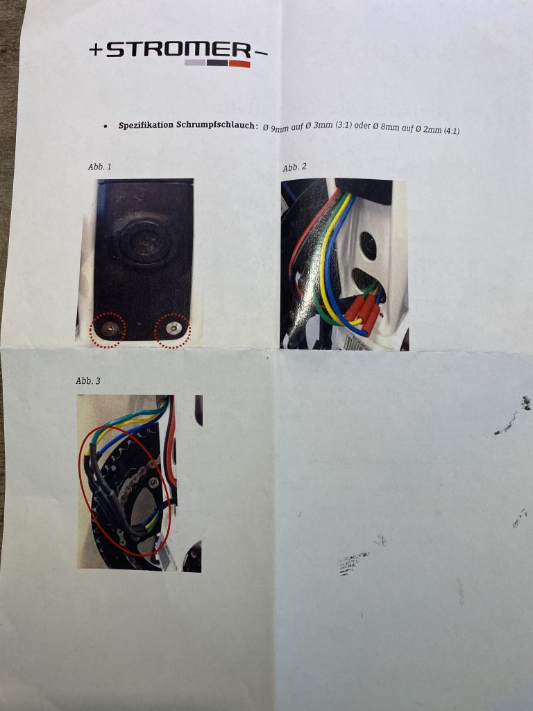

If not already done, there is a Service Bulletin 2 that recommends isolating the wires from the motor connector to the controller.
